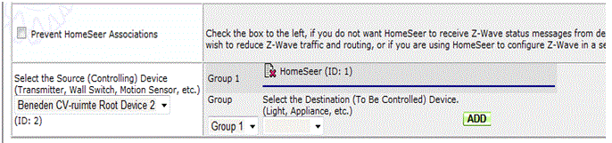

Re: Everspring doorsensor configuring OFF delay
Is there a association with Homeseer?
You can check this in the association setting of the doorsensor.
See the last picture in my review
http://blog.tane.nl/?p=178
Without association Homeseer will never notice status changes.
Tane,
I made an association between the sensor and homeseer below is what i see....
I only see homeseer and not the sensor
Your picture shows both devices or is it ok so because now IT WORKS !!
The attachment is not uploaded.
Sorry, post is edited...
