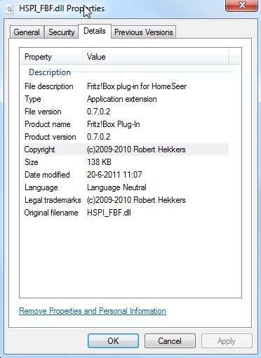

Strange, model 7390 has been added in 2011 (I think it was in 0.7.0.2...)
I checked the 0.7.0.2 source code and everything says 0.7.0.2...
Please check file sizes, dates & times with those in the archive. http://www.hekkers.net/files/FBF_0702.rar
Also check the properties from Windows Explorer:
Capture_02 2012.01.07 22.59.39.jpg (43.64 KiB) Viewed 18029 times
A common mistake is to update the Plugin files while Homeseer is still running (and has those file in use).
You could also (if you want to keep your history) manually check your existing database with the one provided in the archive and see if all fields are there.
Cause that's where it's going wrong. But first make sure everything is 0.7.0.2 (both dll's)
HTH
