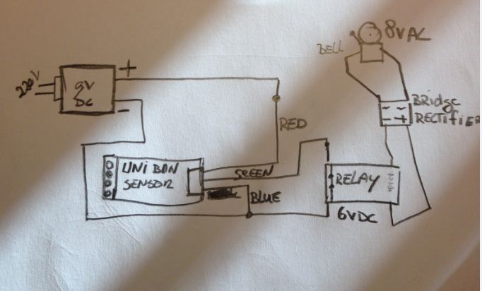

Connect your existing Doorbell to your home automation environment.
I have chosen to use the Universal binary sensor from Fibaro .
The first “problem” that I encountered was that the current of the Doorbell is 8 volt Alternating (AC) current. So I had to change the current to direct (DC) current.
Second “problem” the doorbell couldn’t directly connect to the Universal binary sensor.
After visiting some other Domotica websites I found the solution for my two problems.
The first problem is solved by a “bridged rectifier”.
The second problem is solved by a relay.
So here is what I have done to get it all to work….
Things that you need:
- Fibaro Universal Binary Sensor
- Relay 6VDC
- Bridge rectifier B40 (Diotec)
- Universal power adapter (9VDC)
- Some wire
- A plastic box to put everything in.
Connect one side of a wire to the “bell” and the other side to the Bridge Rectifier.
On the Bridge rectifier is a marking stating where you can connect the alternating current from the bell. Markings are two ~ signs.
The other two markings: location of the direct current output of the bridge rectifier. ( + and – signs). These connections are connected to the relay.
The Universal Binary Sensor is connected to “switch part” of the relay.
I have chosen for the “always closed” state of the relay. This gives in Vera a nice green icon. When the pushbutton is pressed, the icon will turn red and when the pushbutton is released it will turn green again .
Connect the red wire to the plus of the power supply.
Connect the ground wire (blue) to the min of the power supply.
See drawing to simplify:
plaatje
plaatje

I don`t think the drawing is complete because i`m missing the powersource for the doorbell. Another thing i noticed is that you are using 9v powersource for a 6v relay. I think the relay won`t last long in that way.

raymonvdm wrote:I don`t think the drawing is complete because i`m missing the powersource for the doorbell. Another thing i noticed is that you are using 9v powersource for a 6v relay. I think the relay won`t last long in that way.
Note: When i replaced my doorbell i chose an version which is both battery powered and fixed power. If the unit is battery powered it will also be a DC version and not AC :D
Note2: My Univseral sensor is not notifying my HomeSeer, do you need to poll the sensor or is it sending updates ?
Thanks for mentioning the drawing defect. :D, the powersource is 8V AC.
The coilvoltage of the relay has a maximum of 8v DC and the coil is connected to the "Bell". With the Bridge rectifier the outgoing voltage should be between 8v and 6v.
So i think that the relay should last. But time will tell. :)

The doorbell is stll working.
With the automater app i get pushmessages to my iPhone and iPad.
Still very happy with the solution. :D
