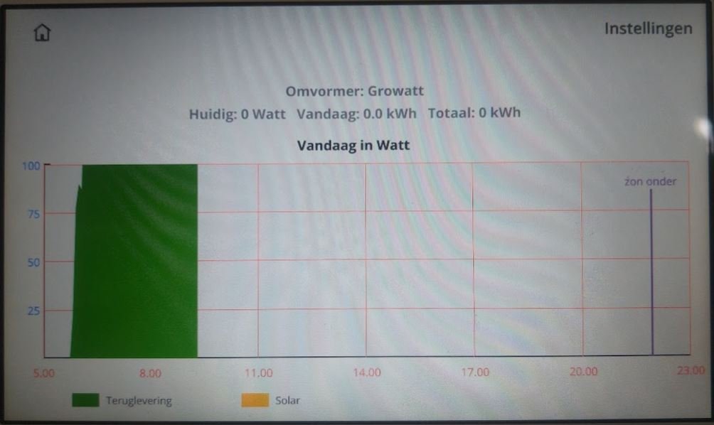

Same here; On https://server.growatt.com/ and in ShinePhone App I can see current data from my Growatt, but not (in text) in the solarPanel app as of today (15-6-2022).
My login credentials seem to be correct, checked Udates for Growat (both versions show 1.0.10) and Force Reload og Growatt and even restarted the Toon(2), but all to no avail....
The graph is seems to be completely green, apart from the time the toon restarted.
What could be wrong?

Just found out that, contrary to the text values, the graph IS being updated, but the scale is wrong. Looks like Growatt has changed something in their numbering / decimals or so.
See the attached image.

The green graph is not the solar but is the reverse power to the grit (production). So you do not receive the info form the Graowaat inverter. I have looked into it and it seems that they have changed the complete API. I am wording on it.

Growatt is aangepast in versie 1.0.12 even een "controleer op updates doen in de instellingen van solarPanel"
