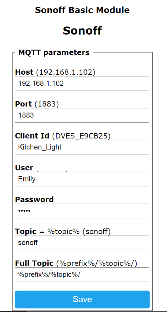

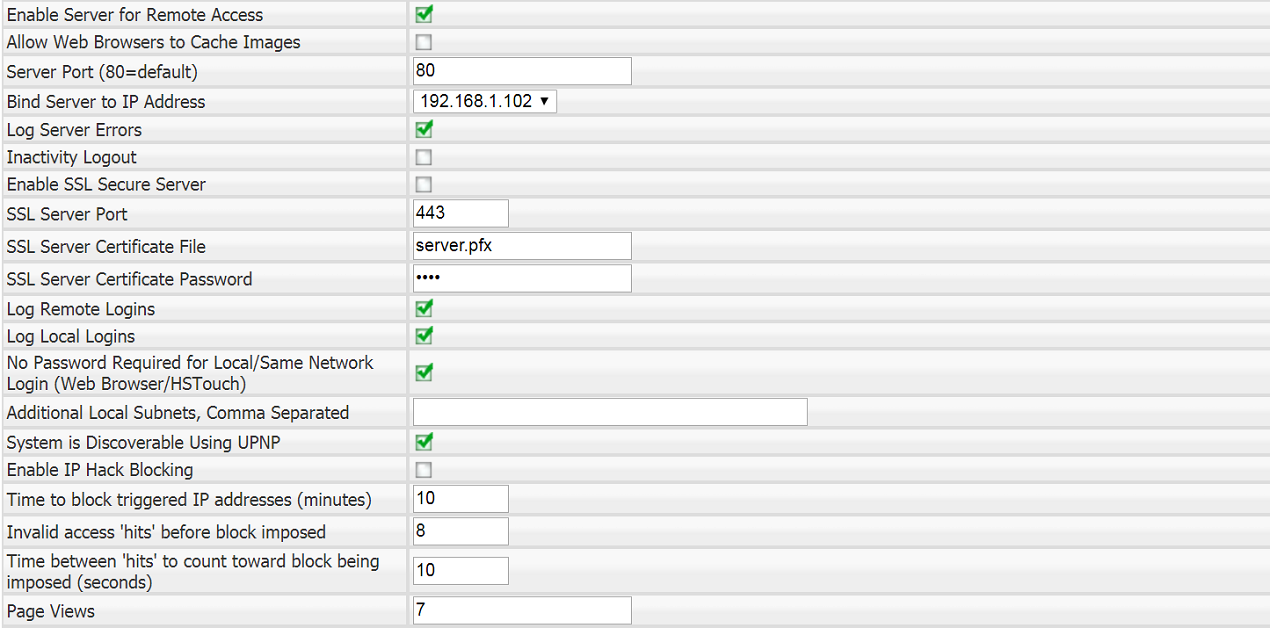

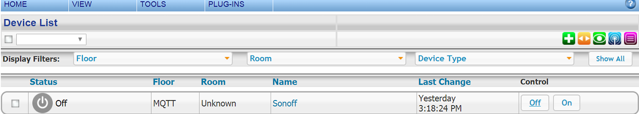

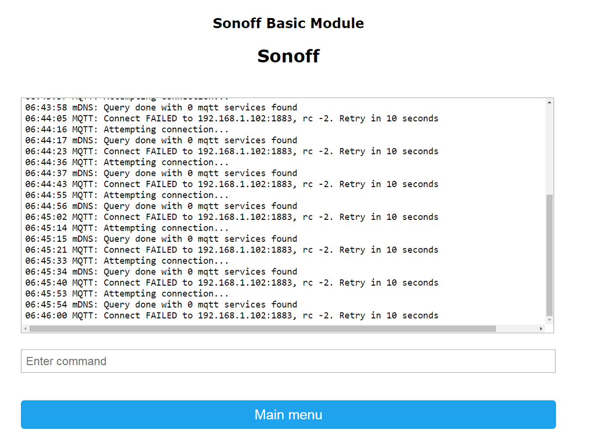

Hi guys
I want to integrate my HS3 with sonoff relay using MQTT protocol
https://www.itead.cc/sonoff-wifi-wireless-switch.html
I have flashed sonoff with Tasmota and currently connected with my local network
https://github.com/arendst/Sonoff-Tasmota
HS3 and mosquito broker is installed on same computer running windows 7 with IP 192.168.1.102
kindly Help me for setting up sonoff device
Emi
Images are attached
Emi
Images are attached
