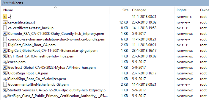

Posts: 1918
Re: Toon app: Buienradar
mine looks like this, I see more entries in your folder.
