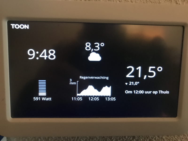

For some time now, my Toon shows some rain to be expected while there realy isn't any rain forecasted. I feel it to be roughly at the same time showing the same rain expectancy pattern every day; asif some buffered data is replayed.. Yesterday I updated to 8.4.1. hoping to fix this 'glitch' but this morning I saw it's still there..
but the radar is showing nothing..
Any clue?
Posts: 1918
Re: Toon app: Buienradar
the source of this rain prediction data is http://gadgets.buienradar.nl/data/raint ... 1&lon=4.52 (example)
The latitude (breedtegraad) and longitude(lengtegraad) are taken from the two files selectedLatitude.txt and selectedLongitude.txt.
Can you check whether these two last files exist in /qmf/qml/apps/buienradar ?
If not, click on the rain tile, press 'locatie' in the top tight corner and set these two coordinates for your location.
If that all looks fine, you can check the gadgets url manually with your coordinates to see if that delivers different data (the first three digits om each line contains the rain data).
Let me know if this all looks fine and you still see something different on Toon compared to the gadget file.
Kind regardz,
Strijker

Yes, those files exist and contains valid data which in turn delivers a table from buienradar.
Thank you for the link, I will check it the moment I catch a false prediction graph again.
How frequent is this data being polled?
Posts: 1918
Strijker wrote:Yes, those files exist and contains valid data which in turn delivers a table from buienradar.
every 5 minutes
