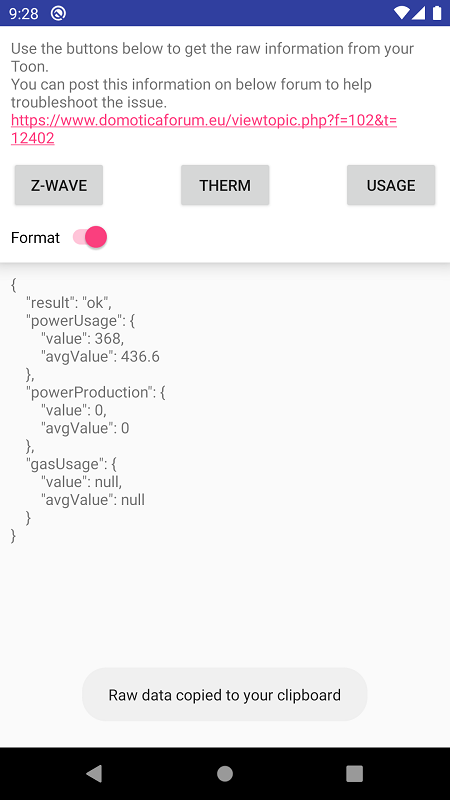

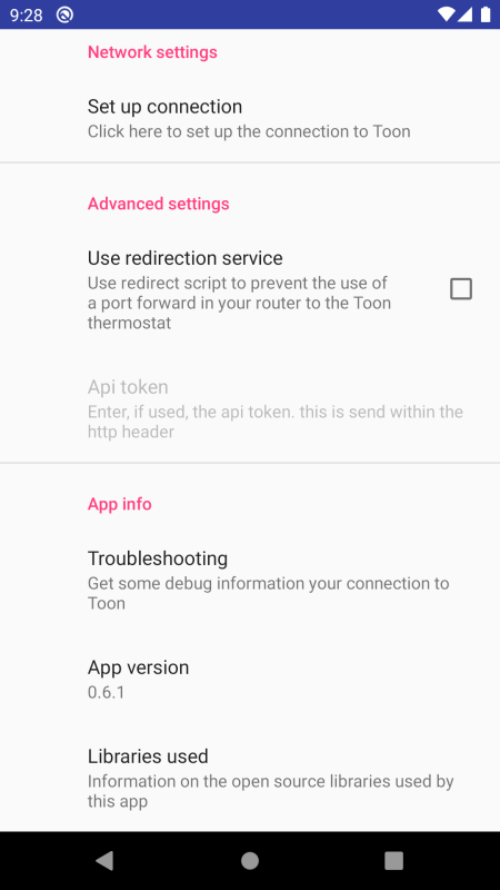

New version 0.6.0 for Alpha testers:
- Add option in settings to disable Gas (which hides it from both controls fragment and drawer) (solves #13)
- Bugfix for #27
- Add dialog for OpenTherm & communication errors (#23)
- Add extra screen in settings for debugging issues (#6)
- Bugfix for #29
- Bugfix for #31
Debugging:
