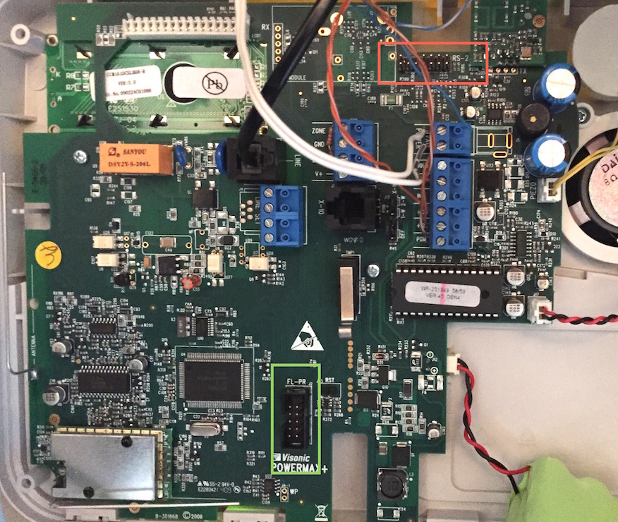

So I opened up my panel - apparently my 2x5 header isn't labeled PC/IR but FL-PR (Flash/Program ?):
PCB
PCB
Panel
Panel
When connecting to this port (the one marked by the green rectangle) I get a different output than before :-) but unfortunately still nothing passing the checksum test.

I'll go poke around on my spare Powermax+ to see whether there are other serial IO's on that port.
I initially found out about that port via this post: http://www.raspberrypi.org/forums/viewt ... 44&t=25890

Hi again
Ok - I am finally making progress :-) :
I have now again connected to the top 2x7 pin header - using the pins shown here:
Powermax+ serial port
Powermax+ serial port.png (97.13 KiB) Viewed 24549 times
I then set up a ser2net daemon on the Raspberry Pi, sharing its serial port over the network.
On a Windows 7 PC I then installed RealTerm and enabled capturing in HEX.
I then initiated Powerlink pairing on the Powermax+ panel - getting this capture:
0D   AB 0A 00 01 00 00 00 00 00 00 00 43   06 0A
(I filled in blanks to show preamble, message, checksum and post amble)
The above two comm strings are exactly as expected, when the Powermax+ panel initiates Powerlink pairing - so now I am sure I found the right port to use :-)
I'll try to compile the pmaxd daemon on another platform (first try will probably be Debian)...
/Nicolai
