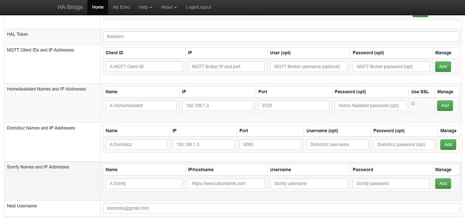

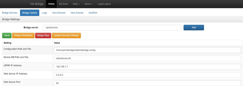

Attached are 2 screenshots of de WebUI of the HA Bridge. To be complete, within the bridge control is support for: Vera, Harmony, Hue, HAL, MQTT, HomeAssistant, Domoticz, Somfy, Nest, LIFX.
On the specific device page you can select and add the devices, then the devices pop up at the 'bedienpaneel'.

Marijn
Posts: 40
Joined: Wed Jul 03, 2013 8:13 pm
Post by Marijn »
You don't have to switch to ha. Ha is just a bridge. If you fill in your domoticz config details, ha bridge will load al your devices. Then you can select wich devices have to show up on toon.
domoticz will still control al your modules.
