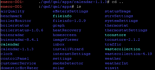

I'm afraid I haven't carefully explained my finding. Now I think of it; it may be because an already existing installation or leftover was there already which shows the other view. I have included a screenshot of my folder to clarify this further.

it looks like your folder buienradar is not a symbolic link to buienradar-8.4.1 but probably contains the full app as well.
My advise it to uninstall the app via ToonStore, manually remove the folder buienradar and reinstall again via ToonStore.
Then you should be good to go.
You are right that it is probably the result of a pre-toonstore manual installation.
When an old manual installation exists, the creation of the symbolic link fails.
(Same is valid for the boilerstatus app)
