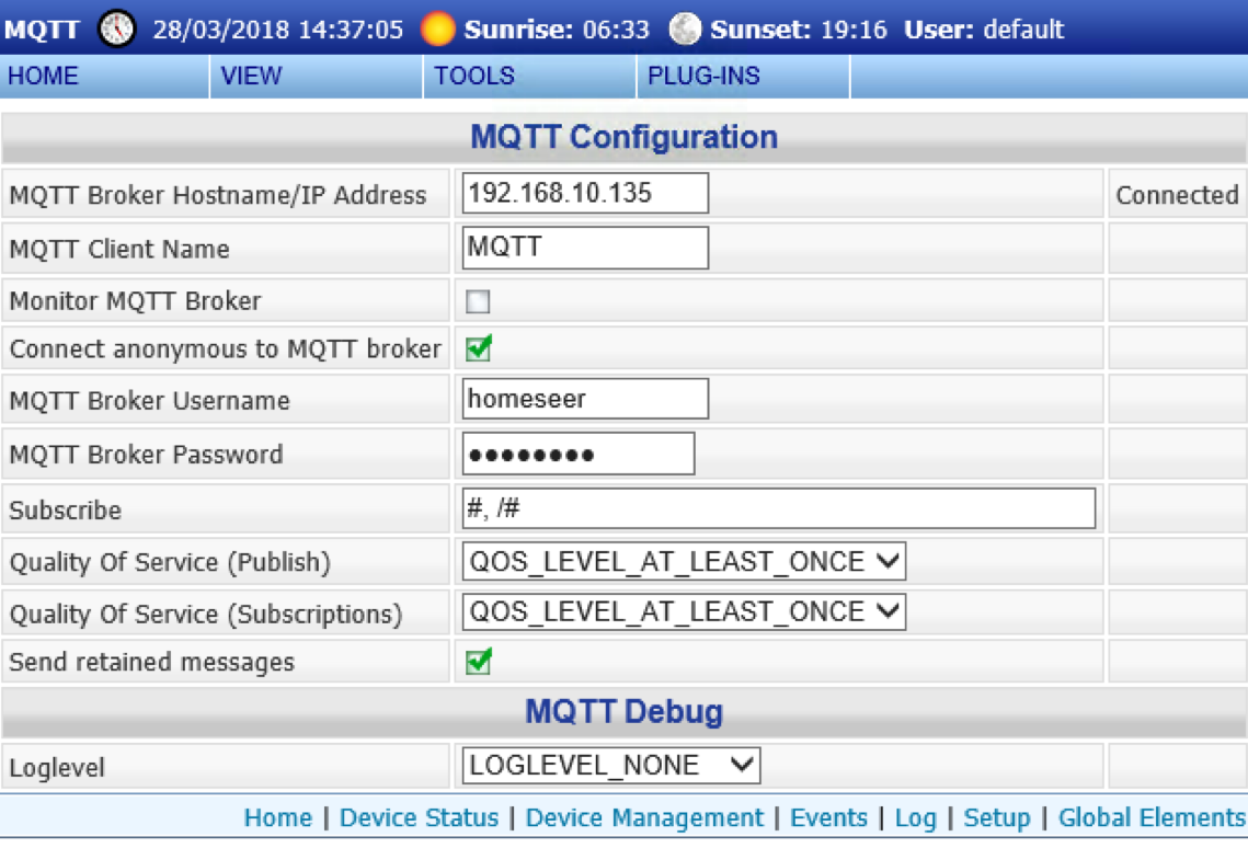

Everytime i start up Homeseer, I find that "Monitor MQTT Broker" is disabled?
Can I alter this? Is this a Bug?
See attached.
See attached.

the 'monitor' broker setting is non-persistent. Idea at the moment of implementing was to prevent a flood on subscriptions, so it is not a bug - it is a feature.
Regards,
Geert-Jan
