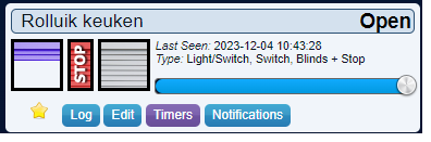

Posts: 192
Re: Toon app: DomoticzBoard
Post by Xavier »
it's set to type: "Light/switch, Switch, Blinds + Stop":
Domoticz blinds type.png (17.27 KiB) Viewed 8011 times
Posts: 1918
can you share the details of this switch as you get it via the api: <domoticz_IPaddress>/json.htm?type=command&param=getdevices ?
