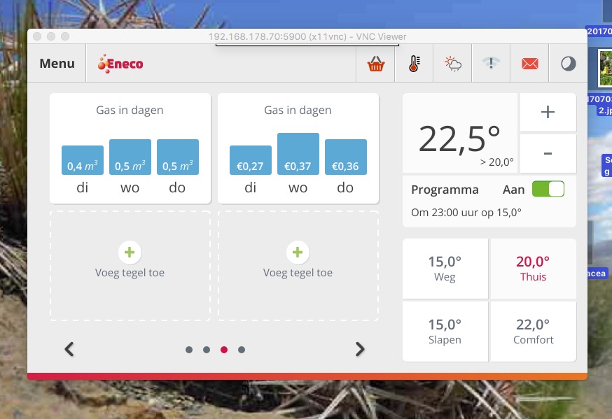

How do I get a (double) tile away? I was busy adding domoticzBoard, could only find all of gas and energy, had nothing selected from it, but 2 tiles were used with gas.

Press and hold the tile a few seconds, then a delete option will show
