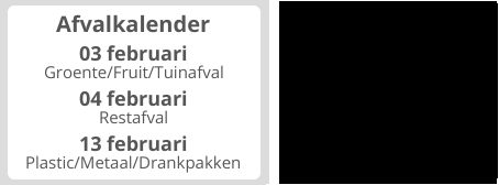

This is what I did so far:

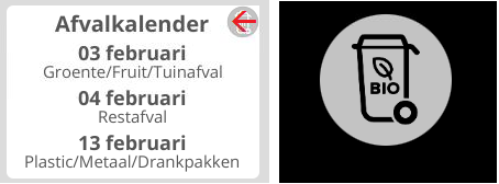

When waste needs to be collected the next day and the waste icon is shown you see a new button on the tile:
You can click the button with the red arrow when you have put the waste out in the street.

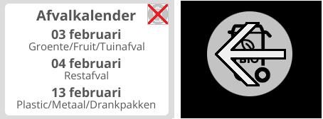

Screen then looks like this to show you will need to collect the empty container.
You can click again on the button on the tile (red cross) to confirm you have collected the container and the icons will be removed.
