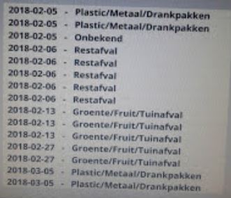

Post by Hypermobile »
Thanks for the Update; nice to see all future entry's
Is there a way to get rid of multiple entry.
See Picture.
Maybe you can implement a Filter to see if entry 1 equals the next; and Then Hide that one.
Which provider do you use? Which city? (can also PM me)

Posts: 1918
sometimes they change the format of their website or the waste descriptions. Will have a look after the weekend.
EDIT: weird indeed, seems that the JSON datafeed sucks a bit for hvcgroep.nl at the moment.
Anyway, I added "PAPIER" , will be in next release.
As you said I also need to build a filter to remove the duplicates (or maybe you can ask them to fix this on their end ;-) )

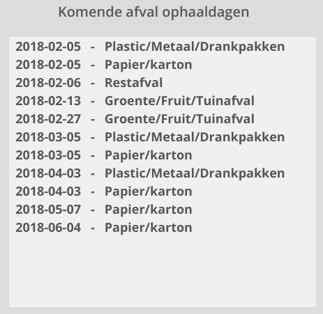

Hypermobile wrote:Thanks for the Update; nice to see all future entry's
See Picture.
Fixed it in 3.1 for all Hvcgroep.nl users (and added the PAPIER description).
Will be released in the coming days somewhere....
Your list is now looking like this:
