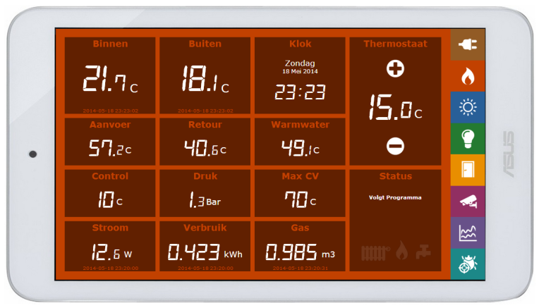

Would it be possible to add a value to the PS=1 report which indicates if a Room Setpoint Overrule is active ? I am developing a thermostat which uses values from the PS=1 report. This thermostat needs to 'know' if the room setpoint is overruled or not for showing the appropriate controls.
