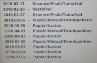

Toonz wrote:
Hypermobile wrote:Thanks for the Update; nice to see all future entry's
Is there a way to get rid of multiple entry.
See Picture.
Maybe you can implement a Filter to see if entry 1 equals the next; and Then Hide that one.
Fixed it in 3.1 for all Hvcgroep.nl users (and added the PAPIER description).
Will be released in the coming days somewhere....
Your list is now looking like this:
The attachment hvcgroep_fix.png is no longer available
Saw the latest release :-) we're getting there.
i didn't looked it up on the interweb; But i see three times in a row. "Papier/Karton"
And just one "restafval"
i think i need to buy a press; to fit all my waste into my container :D
maybe the filter is a little too heavy?

Hypermobile wrote: maybe the filter is a little too heavy?
Will have a look later this evening, thanks
I'm sorry, the filter is correct, the data input from hvcgroep.nl is utterly rubbish:...... (on feb 20th they come 4 times to collect restafval.....)
"adresId":"","code":"GFT","naam":"GFT","icon":"gft.png","dateTime":[{"date":"2018-02-13 00:00:00","timezone_type":3,"timezone":"Europe\/Amsterdam"},{"date":"2018-02-13 00:00:00","timezone_type":3,"timezone":"Europe\/Amsterdam"},{"date":"2018-02-13 00:00:00","timezone_type":3,"timezone":"Europe\/Amsterdam"},{"date":"2018-02-27 00:00:00","timezone_type":3,"timezone":"Europe\/Amsterdam"},{"date":"2018-02-27 00:00:00","timezone_type":3,"timezone":"Europe\/Amsterdam"}],"opmerkingen":"","alt":false,"datums":["dinsdag 13 februari","dinsdag 13 februari","dinsdag 13 februari","dinsdag 27 februari","dinsdag 27 februari"]},{"id":"ee77b91da50ba360445eebbe541c9581","adresId":"","code":"REST","naam":"REST","icon":"rest.png","dateTime":[{"date":"2018-02-20 00:00:00","timezone_type":3,"timezone":"Europe\/Amsterdam"},{"date":"2018-02-20 00:00:00","timezone_type":3,"timezone":"Europe\/Amsterdam"},{"date":"2018-02-20 00:00:00","timezone_type":3,"timezone":"Europe\/Amsterdam"},{"date":"2018-02-20 00:00:00","timezone_type":3,"timezone":"Europe\/Amsterdam"},{"date":"2018-02-20 00:00:00","timezone_type":3,"timezone":"Europe\/Amsterdam"}],"opmerkingen":"","alt":false,"datums":["dinsdag 20 februari","dinsdag 20 februari","dinsdag 20 februari","dinsdag 20 februari","dinsdag 20 februari"]},{"id":"1bce248267719c42ea142d573ea750a6","adresId":"","code":"PAPIER","naam":"PAPIER","icon":"papier.png","dateTime":[{"date":"2018-03-05 00:00:00","timezone_type":3,"timezone":"Europe\/Amsterdam"},{"date":"2018-04-03 00:00:00","timezone_type":3,"timezone":"Europe\/Amsterdam"},{"date":"2018-05-07 00:00:00","timezone_type":3,"timezone":"Europe\/Amsterdam"},{"date":"2018-06-04 00:00:00","timezone_type":3,"timezone":"Europe\/Amsterdam"},{"date":"2018-07-02 00:00:00","timezone_type":3,"timezone":"Europe\/Amsterdam"}],"opmerkingen":"","alt":false,"datums":["maandag  5 maart","dinsdag  3 april","maandag  7 mei","maandag  4 juni","maandag  2 juli"]},{"id":"14400684f6bfd7233e64b97a61001aef","adresId":"","code":"PMD","naam":"PMD","icon":"plastic.png","dateTime":[{"date":"2018-03-05 00:00:00","timezone_type":3,"timezone":"Europe\/Amsterdam"},{"date":"2018-03-05 00:00:00","timezone_type":3,"timezone":"Europe\/Amsterdam"},{"date":"2018-04-03 00:00:00","timezone_type":3,"timezone":"Europe\/Amsterdam"},{"date":"2018-04-03 00:00:00","timezone_type":3,"timezone":"Europe\/Amsterdam"},{"date":"2018-04-30 00:00:00","timezone_type":3,"timezone":"Europe\/Amsterdam"}],"opmerkingen":"","alt":false,"datums":["maandag  5 maart","maandag  5 maart","dinsdag  3 april","dinsdag  3 april","maandag 30 april"]}]
your screen is matching these dates.... :-)

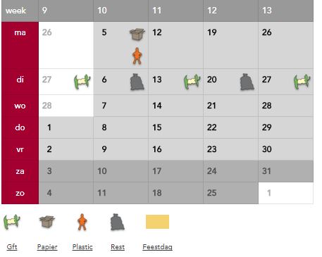

Post by Hypermobile »
stupid hvc :|
I think HVC messed up the Waste-Tags.
Can you post the URL;
Then i'll try to contact HVC so they can maybe fix this.
Attached calendar March 2018
