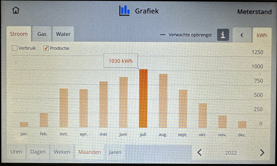

Arnout2000
Posts: 115
Re: Copy Historical data (rra databases) between Toons
Post by Arnout2000 »
I know, but all my historical solar data was already succesfully imported. See this information on 2022:
It is only the information in the Zonnepanelen app which doesn't seem to take the historical data into account...
oepi-loepi
Posts: 681
Post by oepi-loepi »
I do not know where that app takes the data from..
oepi-loepi
Posts: 681
Maybe hou can change the start date of the solar panel installation somewhere in the xml files, maybe toon uses that as starting date for the calculations from the databases.
All like mentioned here:
viewtopic.php?p=98175#p98175
Arnout2000
Posts: 115
Yes, manually correcting the InstalledDate in the file: config_happ_pwrusage.xml did the trick so all data is correct now.
Thanks!
