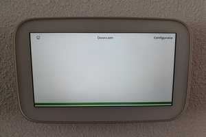

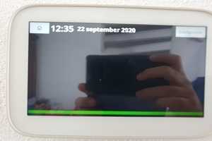

So it goes faulty again.
See the pics I took.
Image with black screen is when doorbell is pressed and popup is visible on Toon2
Image with white screen is when | press the icon on toon 2 of the doorbell app.
Only solution to go back to normal is rebooting toon (poweroff by taking it from the powersocket).
This only happens with this version of the app.
When using the 1.0 version everything works just fine.
Any idea on how to fix this problem?
oepi-loepi
Posts: 681
Re: Toon App: DoorCam
Post by oepi-loepi »
But it did work for some time and all of a sudden is crashes everytime you use it? Did you do an update or did you add another program to the toon or something like that? The difference between version 1 and the current is: assistance for ha, different location for settings file, different location for images and better 16:9 support. In your case it looks like the settings file or the standards images get lost. Can you upgrade to a newer version of toon firmware? Can you also check the mnt/data//tsc folder? It should contain the file doorcam_userSettings.json with the correct settings.

Oepi-loepi,
Thats the strange part, since I'm not always at home when the doorbell rings I haven't paid attention since when it went wrong, I haven't done anything (no upgrades or extra apps installed or what so ever).
I'm running my Toon2 on the latest firmware (not BETA) which is 5.18.8.
I checked the folder mnt/data/tsc for the file doorcam_userSettings.json and the file is on this location.
In the file the following:
{"camURL":"http://IP-ADDRESS_DOORCAM:PORT_DOORCAM/CGIProxy.fcgi?cmd=snapPicture2&usr=USERNAME&pwd=PASSWORD","domURL":"http://IP-ADDRESS_DOMOTICZ:PORT_DOMOTICZ","entity_id":"entity_id","haURL":"http://192.168.10.18:8123","idx":"12","tmpForceMode":"No","tmpdomMode":"Domoticz","token":"haToken","var":"ShowDoorCamToon"}
I don't have/use "ha".
