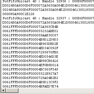

I see at random 0061 coming in without having to request for it.
It looks like a heartbeat (last Seen) for every Circle in the network
Looks like its pushed to the comport :)
So this could be very handy to check if all your circles are available without a request!
Can somebody confirm or test this also?
zonique
Posts: 9
Joined: Wed Aug 11, 2010 12:06 am
Re: Firmware version 2 Plugwise protocol and POL 2.0
Post by zonique »
Yup, have seen the same thing after upgrading to the latest firmware.
OK Thanks Zonique
That is good News!
I will do some more testing when I'm at home (still in Italy now)
But I think Maarten can add this to the document.

Finally got my set and got most of it working. However I don't see the 0061 at all. Do I need to trigger something first?
Right now I am testing with the Circle+ and one extra Circle. Maybe it starts working when more Circles are attached. In that case I will get there later today..
I also see the Source software send a 004A000D6F0000xxxxxx3C01 -> Anybody?
Bwired wrote:I see at random 0061 coming in without having to request for it.
