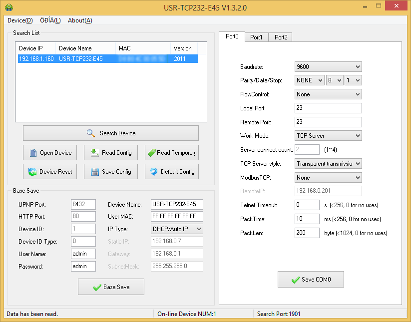

@nlrb, is it possible for you te insert a screenshot of your USR-RS232 settings?
I use at this moment the converter as a TCP-HOST on port 966 (default)

In otmonitor or the Vera plugin I can connect to 192.168.1.160:23.
- USR-TCP232-E45 setting.png (30.99 KiB) Viewed 23862 times
