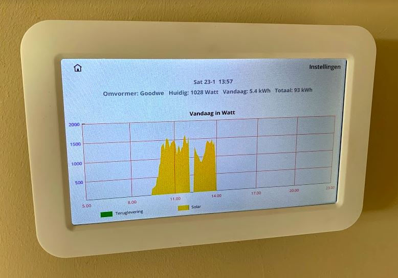

I have a question about the teruglevering. is there a reason why it's not showing in the graph? I'm currently generating more power then I'm using but not spotting details about this.

SolarShed wrote:I have a question about the teruglevering. is there a reason why it's not showing in the graph? I'm currently generating more power then I'm using but not spotting details about this.
This was indeed something what was impossible to test since the weather wasn’t tat good and i only have 6 panels myself. As soon as i am producing more than using, i will test and update the app.
