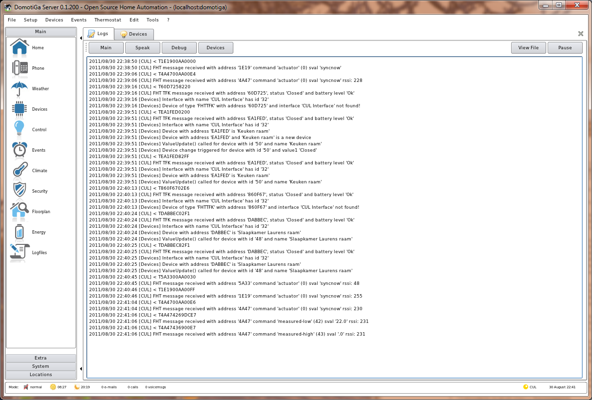

Re: Individual Room Control ELV the MAX!
Post by jrkalf »
*slightly offtopic*
Ron's currently doing a hell of a job coding without having hardware and only having remote access to hardware ;)
I mean, he has the controlling interface (CUNO), but not FS20/FHT modules. He's doing a lot by replaying logfiles and making it work that way
