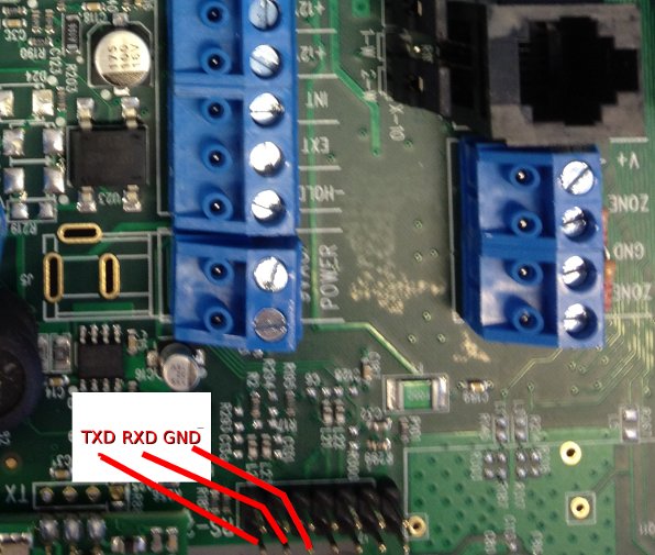

I've traced the 2x7 pin header's pins, and have found that indeed two pins on this header are TXD and RXD. If you are interested, have a look at the attached picture (scroll down). There is a 2x7 pin header on the Powermax+ labeled J7. If you look at this pin header such that the label is normally readable, the 3 rightmost pins of the top row are GND, RXD and TXD. (The attached picture has this header shown 'upside down'.)
J7
XXX XXX XXX XXX GND RXD TXD
XXX XXX XXX XXX XXX XXX XXX
I attached a Sparkfun Basic 3V3 to these pins, selected proper serial communication and was able to communicate with the panel using a Windows XP pc running the Visonic Remote Programmer application, and also using a tiny test program on my meterkast pc that runs Ubuntu 12.04.
I'm a bit puzzled because I think that the Powermax+ panel's CPU is powered with 5V, and the IO voltage for a logic high on its UART pins must be at least 4V, while the FTDI board only does 3V3. I've got to measure the actual power supply of the CPU to make sure the right IO voltages are used, but I'm quite pleased so far.

Post by rolk »
The Powermax+ CPU (M3062LFGPFP) is supplied with 5V. Verified that on my older panel that is retired now. I have no reason to believe that the electrical characteristics have changed, so I have to assume that the CPU is actually out-of-spec tolerant of the 3V3 TX level from my FTDI board, or that board has been patched previously to work at 5V (as this part has been rescued from a pile of electronics, that might be the case). So to be sure, use proper level shifters to work with TTL TX/RX levels or a 5V IO USB-RS232 converter.
