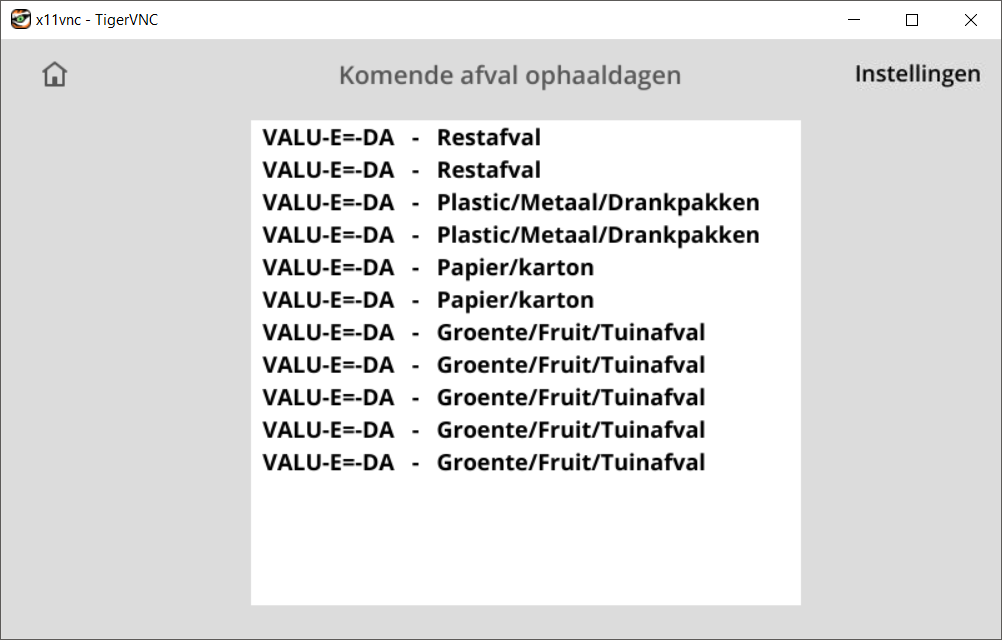

Hi Toonz,
I have an error since yesterday for my waste collector HVC, see attached screenshot and below the contents of the ICS file that I downloaded from the HVC website, I hope this helps in fixing the error, it also happens in the new version:
Error Afvalwijzer.png (107.77 KiB) Viewed 7503 times

Posts: 1918
Re: Toon app: Afvalwijzer
will have a look tonight, not a big deal (will be version 4.12)
