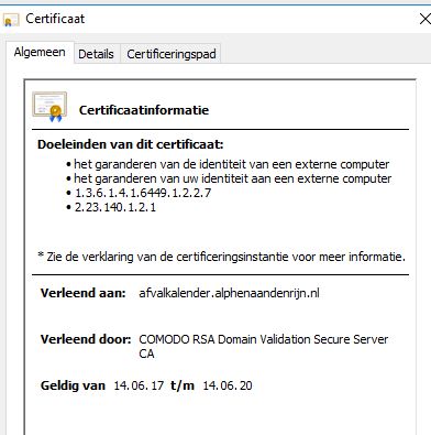

Interesting one, when trying using wget from the prompt:atlantica wrote:Hey Toonz,
Alphen aan den RIjn provider 23 seems to be broken.
the url is still working if I try this on a browser.
Could there be something wrong with te SSL setting?
Connecting to afvalkalender.alphenaandenrijn.nl|213.197.248.196|:443... connected.
ERROR: cannot verify afvalkalender.alphenaandenrijn.nl's certificate, issued by `/CN=opzet-019.ux.is.nl':
Self-signed certificate encountered.
ERROR: certificate common name `opzet-019.ux.is.nl' doesn't match requested host name `afvalkalender.alphenaandenrijn.nl'.

Re: Toon app: Afvalwijzer
The certificate seems to be ok in the browser.... See my attachment...
- screenshot certificate
- 001.JPG (35.65 KiB) Viewed 8742 times
Regards
David
David
Ok this is going to be a bit technical.
The reason is that this site is running on a shared webserver. More websites (with probably also https) running on the same server with one ip address.
Without ssl (https) a webserver can easily spot if the clients is going to http://www.abc.com or http://www.xyz.com as the request for the website is part of the HTTP command (ServerName in the http request). So it sends the correct website to the client which he is requesting.
But with SSL this is impossible (at least, take that for now). The HTTP command (https is just http on a SSL secured line) still requests the correct website however SSL needs to enabled first before HTTP requests are sent. But without knowing which website the client is requesting, the server can't send the correct certificate. So it sends the default one (the us.is.nl one).
So for years, if you wanted to have https on a webserver you needed a dedicated IP adres (binding your website to that IP adres).
But now we have SNI (https://en.wikipedia.org/wiki/Server_Name_Indication). Supporting webbrowser (and curl, wget) can now request the webserver name already in the SSL process. So when SSL is set up, now the server knows which certificate to send.
What is happening with our Toons? They don't seem to support SNI. At least not on your versions. On my toon2 with 5.0.4 it works fine. Probably on a toon1 with 5.0.4 it will also work. This firmware is just released and with a few days we expect it to be available for rooted toons.
