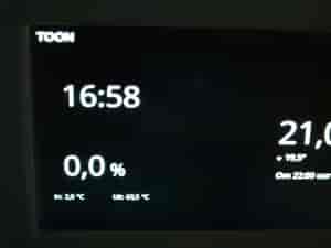

ok i get zero to
how can i solf this

ams123 wrote:Image
ok i get zero to
how can i solf this
Hi Ams123,
this app only works if you have a boiler which is controlled via the OpenTherm interface, not via the on/off protocol (you can check that in your Toon settings)

ams123 wrote:Image
ok i get zero to
how can i solf this
Hi Ams123,
OpenTherm is on
but i have the same problem i downgraded to happ-thermstat_1.554-trunk_qb2 can i upgrade that again

I already changed it in the Code ;-)
now it shows Modulation level
Templar
Posts: 180
Re: Toon app: boiler status
Post by Templar »
Hypermobile wrote: I already changed it in the Code ;-)
In OpenTherm, the modulation levels are shown without the decimal fraction. So you can show it without the decimal separator & fraction.

Nice script but you wrote this to run on a synology, what do i need to change to make this work for a raspberry pi?
And how do i get the percentage in the dim screen instead of the pressure (my Tzerra doesn't report pressure :()
Posts: 1919
gielie wrote:And how do i get the percentage in the dim screen instead of the pressure (my Tzerra doesn't report pressure :()
Will make this configurable in next release (soon) and remove the decimal digit for the percentage. Hang on.... :)
