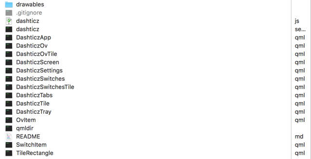

michel30 wrote:So you download the file as one zip file? dashticz_toon-master.zip
When you extract the zip file you will see an map like this: dashticz_toon-master
I renamed this map in dashticz and upload it in Toon , maybe you need to check the rights
What is in your dashticz folder? do you see the config etc. files directly or only 1 folder?

[img]
[/img]

michel30 wrote:[img]
[/img]
I have the same.. don't know why the lightbulb won't show up :(
