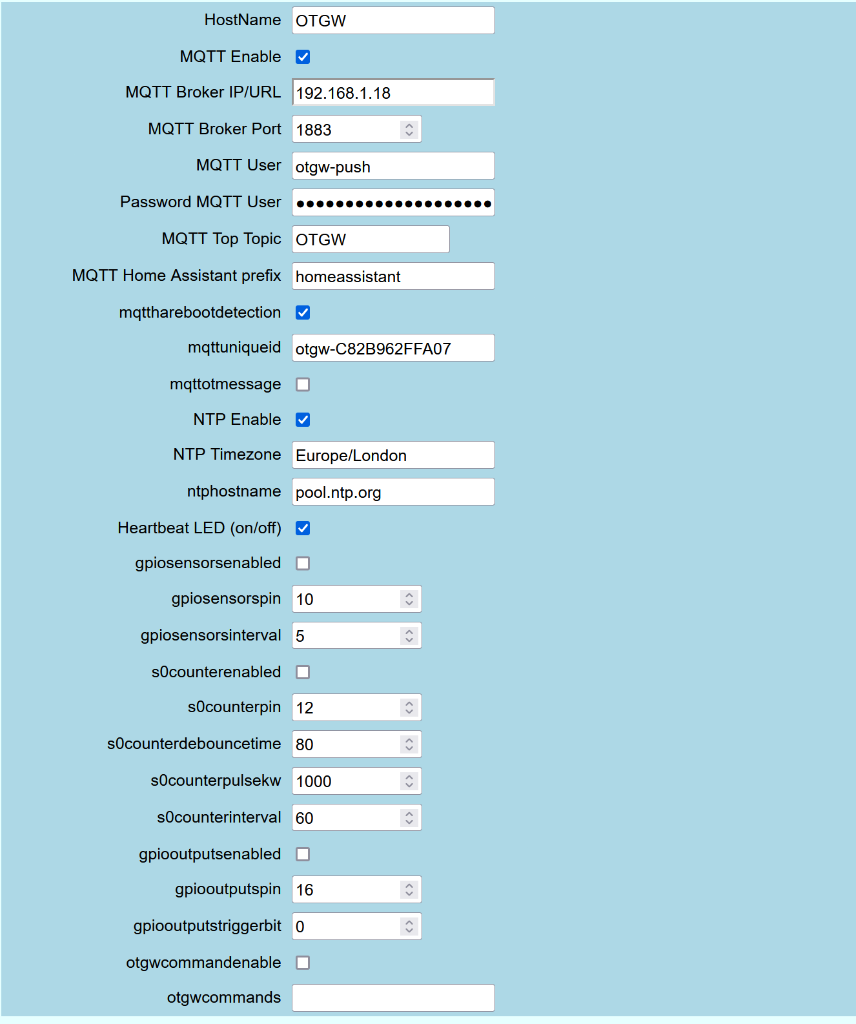

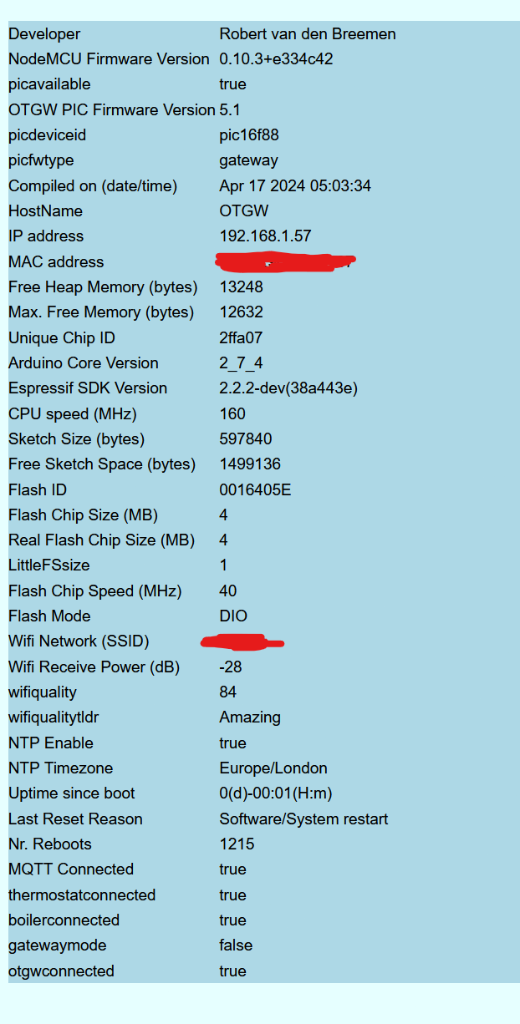

HI, I wonder if anyone could advise, I'm probably missing something.
I have a gateway installed and using OTGW-firmware (version 0.10.3+e334c42) on an ESP device attached and for a couple of years it's been working fine. I've had it reporting to MQTT into Home Assistant and it's been great.
Recently I scrapped the MQTT server and built a new one, just to upgrade to MQTT v5 (from 3.1).
Once ready I removed the existing OTGW device from Home Assistant then connected OTGW-firmware via the ESP to the new MQTT server, but the OTGW device never appears in Home Assistant.
From what I can gather HA expects a config message on a homeassistant topic for autodiscovery, and monitoring this no message ever seems to be sent from OTGW-firmware.
To force a new autodiscovery message, I've tried rebooting the OTGW, tried changing the MQTT server ip, enabling and disabling MQTT in OTGW, power cycling the OTGW hardware, changing the MQTT Home Assistant prefix and changing it back, switching back to the old mqtt 3.1 server, all to no avail.
I'm not up on exactly what should and should not be happening for it to appear in HA, but it seems like OTGW is just never sending autodiscovery compatible messages so HA isn't picking it up. Everything else on my network seems to be sending autodiscovery and is being picked up with no issue, even when removing readding devices, which makes me think it's probably an OTGW-firmware related somehow.
I can log into the MQTT server and see all the data OTGW-firmware is sending when I subscribe to the OTGW topic so it's all connected and sending data about the boiler fine, I can also use the MQTT subscription option inside HA to view the same topic and it's all coming through fine there, it's just the autodiscovery message never seems to appear.
Anyone any ideas?
I guess it is possible I did upgrade to OTGW-firmware version to 10.3 during all this and that's introduced something but downgrading to 10.2 then 10 it still seems the same, no autodiscovery, nothing seems to be sent to the homeassistant topic.

Cheers. It's the mqtt autodiscovery that doesn't seem to work.
The opentherm device should send out an mqtt message under the "homeassistant" topic containing details of each entity it reports, as I understand it this is required for Home Assistant to autodetect the device and its entities. Once discovered you can then enable those entities in HA and it will track the value mqtt messages for each entity.
HA just doesn't seem to discover the opentherm gateway, and it seems to be because OTGW never broadcasts it, I can't see any of the announce messages for OTGW on the homeassistant topic (I can see them for every other device I have).
I can see the OTGW values themsselves reporting to my MQTT server, ie the ongoing boiler temps and all that under the "OTGW" topic are all coming through, just never the config announcements that allow me to configure it in HA.
