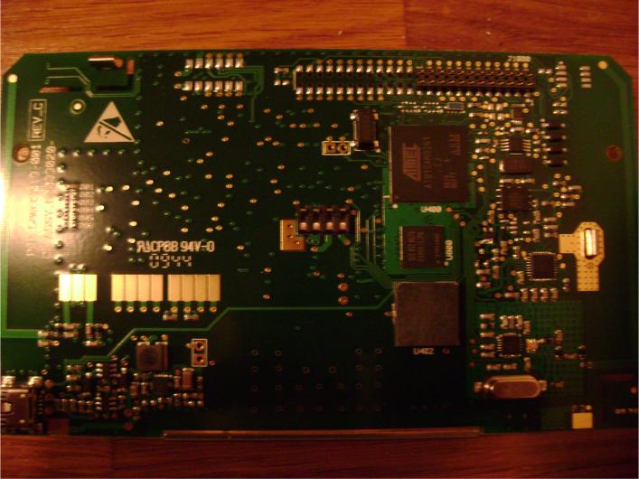

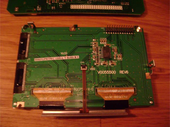

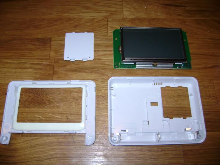

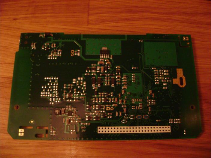

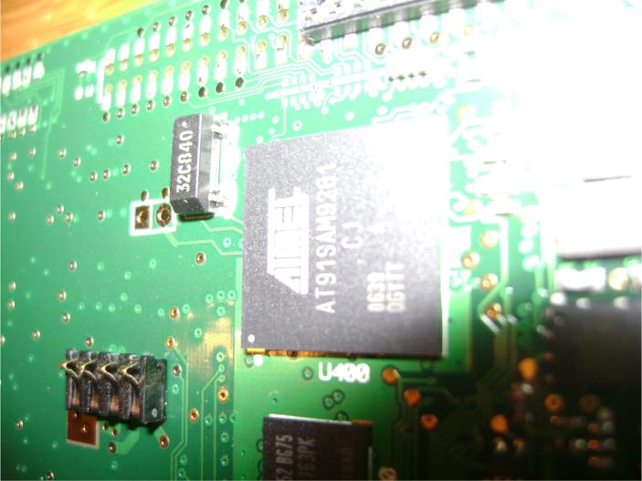

r_255
Posts: 621
Re: Experience with automatic radiator valves?
Post by r_255 »
The Evotouch disected
evotouch disected
evotouch disected
Mainbord under lcd
MAINBORD BACKSIDE
MAINBORD BACKSIDE
Pcb on LCD
Backside Mainbord
Microcontroller Atmel atmel at91sam9261 cj

Wel embeded linux or even wince should be possible on this platform, but that doesnt make it a cm zone controller thats controllable by pc.
Next steps are:
- See what kind of development tools are available and try to find out what honeywell might have used for this device.
- Make a rom dump and try to open it up with some development tools.
and if we know enough about the basics of the system we could hire some external knowledgement or can try to find out ourself.
The last one is kind of hard for some one like me ( got zero knowledgement about these things except for those things i have seen arround here )
