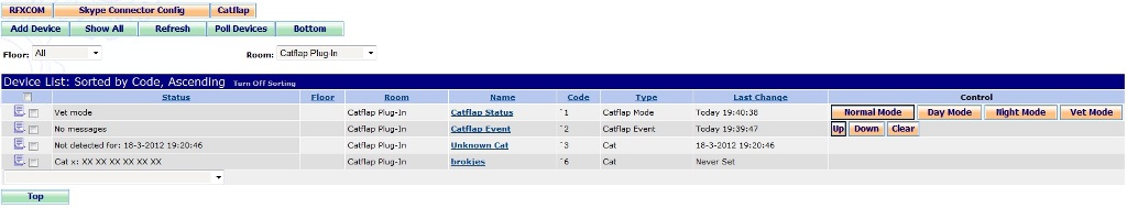

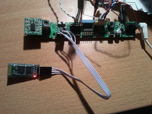

Update:
Received my bluetooth rs232 module. It Works!
I'm working on a Homeseer plugin for the catflap. It's almost done.....
have to do some code cleanup and testing.
With this plugin it is possible to monitor your cats in Homeseer
trigger events and set mode.
If anyone is interested, I can upload it to this message board when it's finished.
