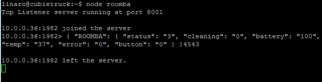

Re: RooWiFi Roomba WiFi control
See below the setting, the Ip port is Ip where Roowifi pushes the json ststus package
so i think in your case it should be the server where Homeseer is running on
then a script in homeseer needs to pick it up
in my case its goes to my cubietruck (Raspberry like)
this notification come every minute and direct when a status is changing, you can also give a clean, pause or dock command via this port.
Beside this you can also use the existing http way to control.
