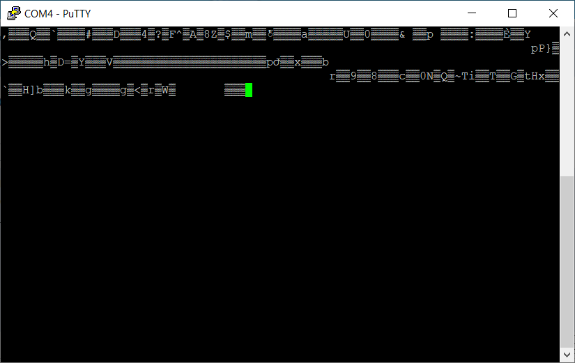

Hi, I just bought a Toon and started using the manual to root the thing.
After connecting the usb to serial to the right pins I only get strange symbols in Putty. Double checked everything but I can't find the problem.
Can't find other posts about this problem, so if anybody knows whats wrong...

Probably wrong COM port settings:
115200 baud, 8 databits, 1 stop bit, no parity.

marcelr wrote:Probably wrong COM port settings:
Using 11520 baud doesn't work :D
Thanks
Re: Rooting Toon (or boxx)
It should, because that's the rate the serial port is working at. Just to be sure, it's 115200, not 11520

marcelr wrote:It should, because that's the rate the serial port is working at. Just to be sure, it's 115200, not 11520
That was the problem, needed the extra 0
