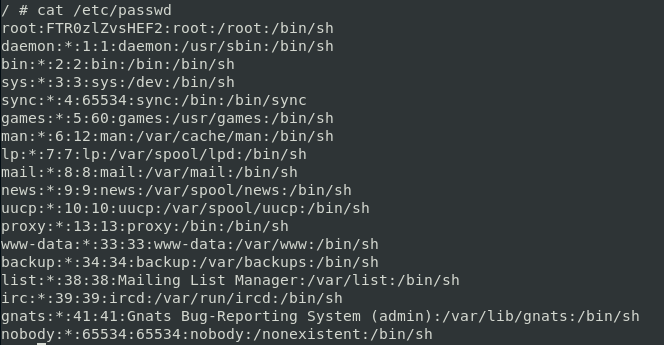

I atttached my passwd file screenshot after saving it with :wq in vi. I pasted the crypt of 'toon' inside the file. This line is also present in /etc/inittab:
# add serial console access: (added, MR!):
gett:235:respawn:/sbin/getty -L 115200 ttymxc0 vt102
- toon-passwd.png (37.12 KiB) Viewed 10745 times

Should be
root:FTR0zlZvsHEF2:0:0:root:/root:/bin/sh
Re: Rooting Toon (or boxx)
Aah, I probably messed it up while copying. But upon rebooting it removes the :0:0, so I still can't login. I can feel that we are almost there
. What could be the reason it removes the :0:0 upon reboot?
