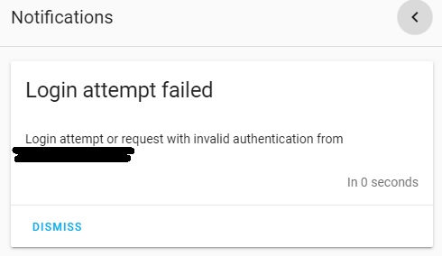

Trying to get this working, but to no avail.
Am I doing something wrong here?
Rooted Toon with firmware 5.18.8 and HA Controller 1.0.6.
Whether I'm using token.txt with an active Long Living Token or the Legacy_API password, I'm getting the same notification in HA every time (see attached pic).
Anyone have any idea? I'm running out lol

xilvaro wrote:Trying to get this working, but to no avail.
You have the Long Lived Token created in HA? Just to be sure (because I tried this when I started using the token), you are not changing the token when HA prompts you the token right? Because from what I remember you can't do that :)
In the token.txt you are not accidentally adding a space that shouldn't be there? Also don't add quotes at the beginning and end like ' or ".
Edit: Maybe try the original HA app on a smartphone to see if external access can be made with that?
Check the following file ip_bans.yaml. Chances are you have blocked yourself now.

Hello all,
I've had the same problem.
It's because the config file directory is moved in the Toon.
The files goes in /mnt/data/tsc
qb-xxxxxxxxxxxxxxxxxxxxxx:/mnt/data/tsc# ls home*
homeassistant.alarm.json homeassistant.switches.json
homeassistant.scenes.json homeassistant.token.txt
homeassistant.sensors.json homeassistant.userSettings.json
homeassistant.sliders.json
So move all the files to /mnt/data/tsc and it will work.
