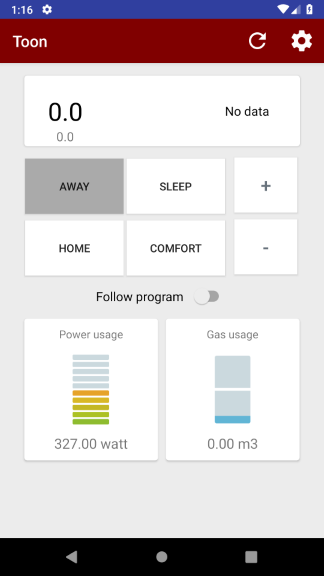

glsf91 wrote:When Away/sleep/home/comfort is selected it is almost not visible that it is selected. Maybe change color background or change color text on button, like on Toon.
I've created an issue for this (to keep track) here:
https://github.com/fabianblom/Toon-Android/issues/5
Should be fixed in 0.5.1
Not the prettiest sollution but it'll do for now:

mAiden wrote:See here what happens when i start the app
https://youtu.be/7nmNibqXUiU
I see.
Since we don't run any analytics software in the app, and the app isn't in the Play store, we don't receive any crash reports, it is very hard to resolve the issue.
You'd could and try and send the logcat to us, but you'd should have some Android knowledge:
https://android.stackexchange.com/quest ... t-a-logcat
Otherwise you'd have to wait until we decide on how to tackle this.
