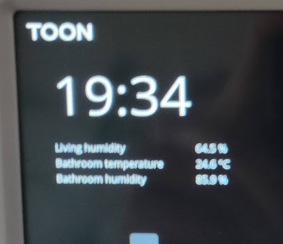

I cant seem to get the clock widget working when the screen is on.
It does work when the screen is dimmed.
Or is it suppose to do so....?

I had also the problem with the time when the screen was activated.
I make change in te HomeassistantTile.qml file on my Toon
https://github.com/Luc-S/Toon-HASS/blob ... ntTile.qml
vi /HCBv2/qml/apps/homeassistant/HomeassistantTile.qml
Text {
text: app.timeStr
color: colors.clockTileColor
anchors {
left: parent.left
leftMargin: 10
baseline: parent.top
baselineOffset: 54
font.pixelSize: dimState ? qfont.clockFaceText : qfont.timeAndTemperatureText - 4
font.family: qfont.regular.name
visible: app.clockTile ? true : false
After a restart of the gui, the time was back. I think something was wrong with the auto scale for Toon 2.

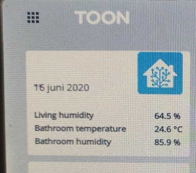

i created an extra widget "HomeAssistantPlusTile" to have 8 sensors on the display instead of 4 sensors and the Home Assistent Logo or the clock ;-)
https://github.com/arcidodo/Toon-HASS/t ... eassistant
maybe there is another way to do it, but this works for me:-)
