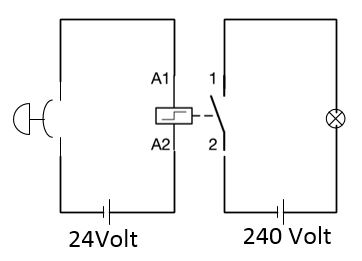

At the moment my lights are switched by Hager EPN513 DIN Bistable or Latching relays (we call them Teleruptors).
The relays switches 240 Volts to my lamps by connecting 24 Volts buttons to it. So when I press a button on the wall it sends 24 Volts to the relay and the relays switches the 240 Volt.
Now my question is, how can I use the unipi to switch my relays and still keep the 24 volt buttons, AND I need to know the state of the relays. Say I switch the lamp on with the UniPi and back out with the button. My software needs to know what happened there …
I was thinking to connect my buttons to the digital inputs of the Unipi (not sure if 24 Volts is going to work) and connect my DIN relays to the relays on the UniPi. So than I can digitally turn my lights on/off with the UniPi and still use my buttons, sins they also switch the UniPi.
Will this setup work?

U can connect the button and the relay of the UniPi and switch them parallel of each other
When one the two switches is closed the light is on. Another option is to use the inputs on the UniPi (are there any inputs on it?)to switch the outputs but if the UniPi fails ..... :(
