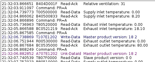

Hello,
I am faced with exactly the same problem.
The gateway is working for some time, but than it only displays the the bus communication, but do not accept any commands on the serial line.
if i start for example the otmonitor, it tries to obtain the firmware version of the gateway, but there is no answer from the gateway. See attached picture.
The same is for all other commands, no response from the gateway.
After cutting the power for a short time, all is working normal again (for some time...).
Do anybody have an idea what i can try?
