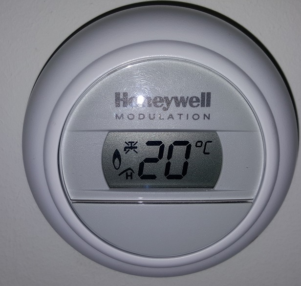

In addition: My room thermostat display has 'f' in display or no display at all.

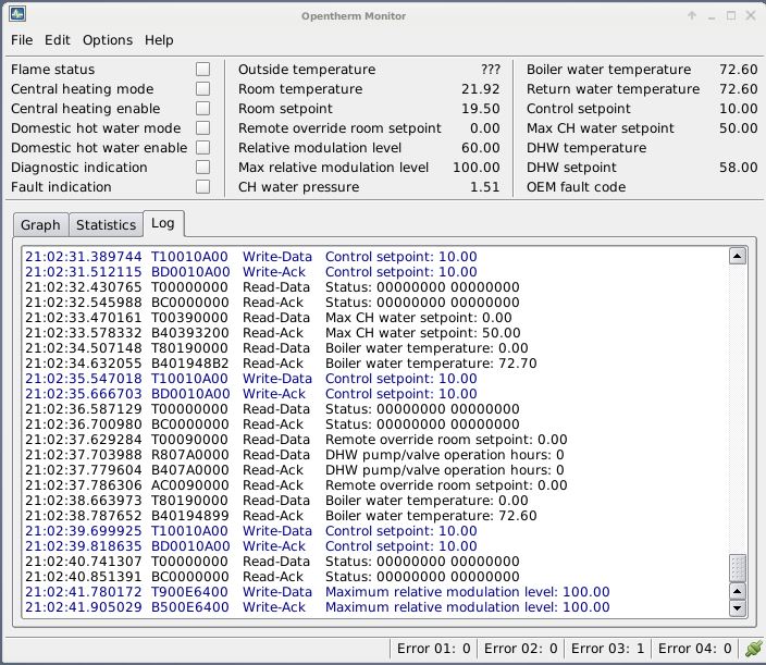

Everything looks fine in those logs, except that the thermostat repeatedly requests the same information. That is usually a sign that the thermostat didn't (correctly) receive the response. The gateway will reset itself when it received the same message from the thermostat 64 times in a row.
The transmission of a message to the thermostat is very basic functionality that works for everyone else and has not been changed between 4.2 and 4.2.5. So I cannot think of any explanation why this would work with 4.2 and not with 4.2.5.

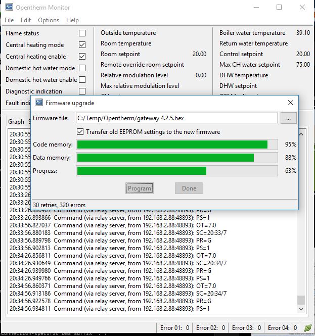

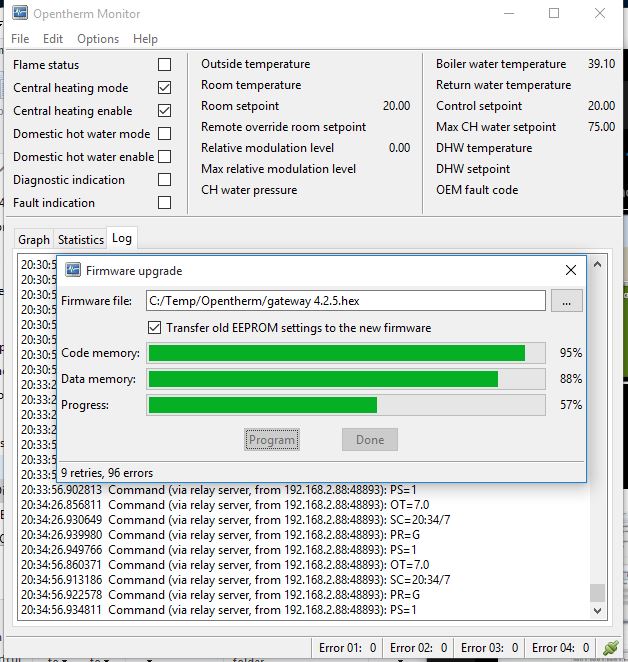

Re: OTGW 4.2.5 reboots often (Agpo Ferroli Megalux 6)
I do hope so the flash will finish correctly....
- Flash FW 2.5-1.JPG (124.85 KiB) Viewed 16447 times
- Flash FW 2.5.JPG (115.79 KiB) Viewed 16447 times

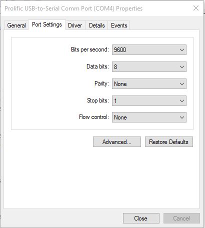

- Windows Setting
- Prologic Settings.JPG (28.08 KiB) Viewed 16358 times

I checked the comport
Gives the following result:
tldp.org/LDP/nag2/x-087-2-serial-config ... ation.html
I would say correct
Meaning in my opinion: 9600 baud NOPARITY 8DATABITS 1STOPBIT,

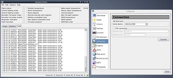

- OT Monitor on Raspberry
- OT-Monitor-Raspberry.jpg (23.08 KiB) Viewed 16315 times

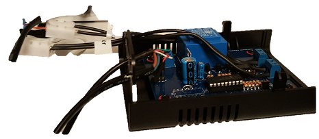

(Solved): OTGW 4.2.5 reboots often (Agpo Ferroli Megalux 6)
Well at least after one week of research progress has been made.
I changed the internal wiring of the OTGW.
The idea came from a post that mentioned 'Floating Ground" posted earlier.
I now used "schakeldraad".
Thicker and more convenient to mount compared to the original telephone wire,
Connectors are now outside of the OTGW box so changing them in case unmount is needed is much easier.
Next stop would be getting Ser2Net to work on the latest 15:05 Openwrt realease for TPLink 703.
Luckily not that much hassle on the Raspberry Pi with Ser2Net. That one works like a charm.

Interesting.
I would like to ask you about Windows 10 driver for Prolific cable - did you manage to make it working under Windows 10?
Mine is not working, I'm getting Error Code 10 and yellow exclamation symbol next to virtual COM port.
Yes it is working under Windows 10Bororo wrote:Interesting.
The new cable with different chipset is on the way and I hope it will work with Win 10.
http://www.ebay.com/itm/USB-to-TTL-Seri ... 1303998507?
I found it here: http://www.ifamilysoftware.com/news37.html
Please let me know if it worked for you.
Have a nice evening
Thank you very much for your help.
The driver from ifamilysoftware working like a charm, no exclamation mark, everything is up and running now.
