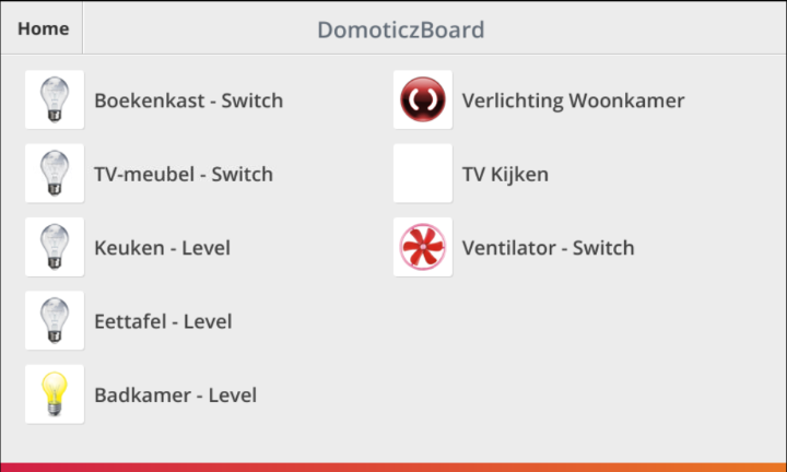

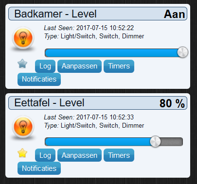

I did edit some pieces of your program but i'm still unable to get the status indicator working for "Keuken" en "Eettafel". The other switches work just fine.
The code is identical to the other switches and scenes.
See the images below.

Ah, i see the issue here. This version of DomoticzBoard only allows ON/OFF switching, while "dimming" is between OFF(value=0) and ON(value=100).
