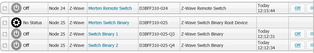

I ead in in the Merten Connect 506219. Is the Connect radio push-button 2-gang.
And the Merten Connect 507502. Is the Connect radio reciever switch 2-gang.
Both work in HS3. Reciever works perfect. The 2-gang remote has only 1 line in HS3 and both gangs give the same signal to HS3 if you push them by hand. But this describt in the file I attached before.
There is also standing: Go to the Modify Device window and make a choice of going directly to Associations or Configure windows.
I like to change nothing. So I opened the Association window.
And now I have to do something I can't find: 'Transmit Node info frame' routine.
Where in the Associatioon can change the Node info frame?
Both devices are read in with the Aeon Stick gen 5. In the attachement it is the Merten remote switch.
- Merten 2-gang switch A.jpg (91.17 KiB) Viewed 8196 times

I think I do something wrong, because the document 'To understand Merten Connect battery powered devices' is saying some comments to practical use.
Perhaps this is only for HS2? I don't know.
