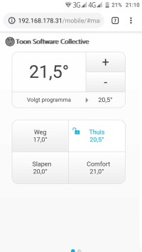

Happy to release a new app in the toonstore called "ToonMobile". This is a TSC modification of the old 'www-toon-mobile' package which was provided by Quby ages ago.
It is available to install from toonstore. It is not a GUI app as the rest is but a webpage/javascript application (in /qmf/www).
This will allow you to control your toon on your computer or mobile phone via the url http://[toon-ip]/mobile from your home network.
And if you open op your router or create a proxy-forward or have VPN towards you home network, you could also control your Toon outside of your home network.
