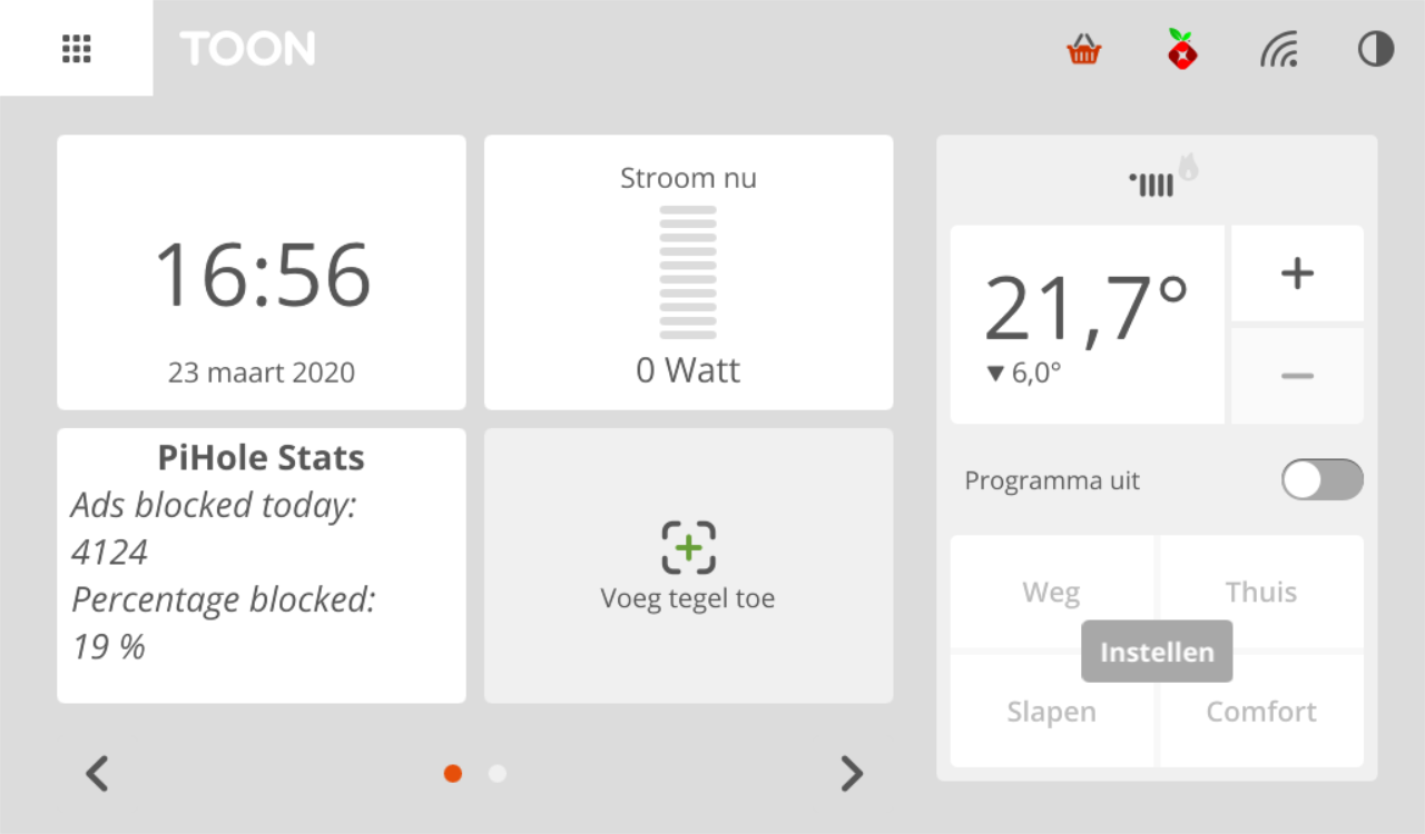

Long time ago i made an app (DomoticzBoard) which Toonz has improved over the time.
Last couple of weeks i brainstormed over new ideas for apps while i was redesigning my homenetwork and i came up with the idea for a PiHole app.
It's just a simple app which queries the PiHole server and shows the stats of PiHole on the Toon.
App has a tile which shows the total ads blocked on that day and the amount of ads blocked in %.
Click on the Tile or the Sys Tray icon shows more information queried from PiHole.

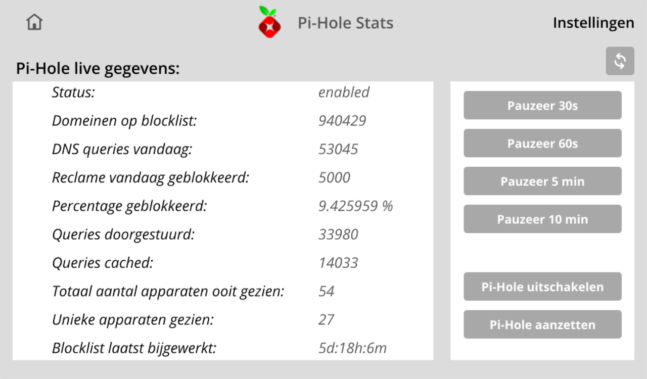

Working on a new version with pre-programmed pause buttons (meaning that you cannot set the timers yourself)Joskep wrote:Okay. But isn.t it an idea to create that option and let the users by themselfes adjust the password-settings in "/etc/pihole/setupVars.conf) via SSH?
Still in a doubt to put a button on the Tile, i prefer not as there's not much space left on the Tile.
Preview:
- Pihole_preview.png (171.65 KiB) Viewed 13597 times

Re: Toon app: PiHoleStats
I just installed the app and i see the button, unfortanatly they don.t work (yet).
It still keeps saying "enabled" and when i go to an ad test page it says i am still ad blocking.
Or am i to quik and you are stil busy

Did you fill in the Token in the settings screen?Joskep wrote:I just installed the app and i see the button, unfortanatly they don.t work (yet).
Or am i to quik and you are stil busy?
It should refresh the screen after clicking a button, if not, give it a few seconds.

I filled in my password, like i do when i login normally. Is that correct?
When i login via cellphone and choose 'disable' the i see the apo on the Toon changes "enabled" into "disabled"
- Administrator
- Posts: 494
- Joined: Thu May 04, 2017 9:28 pm
Web password is not the Token.
You need to extract the token from /etc/pihole/setupVars.conf file

Is it the 64 character after "WEBPASSWORD=" ?
I did in (manually ;-( but the same result.or do you mean another token?
EDIT: WORKS!!!!!
I forgot one character.
Thanks!!!!
