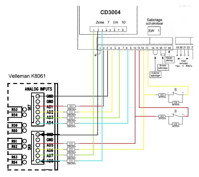

Finally, after a long time, today I also successfully connected my Aritech panel to Homeseer.
My setup looks like the setup which Francois uses, but I am using a Velleman K8061 Extended USB Interface Board.
My goal was to re-use the sensors already in place. In order to achieve this I use the 8 analogue input ports on the K8061 to measure the voltage on the input ports of the Aritech panel. As the Aritech panel expects the currency to be in certain voltage ranges to determine the actual status (tamper, alarm, rest) and the input ports have an resistance of 20 kOhm I added an additional 20 kOhm resistor between each input port on the panel and the input port on the K8061.
For the HomeSeer part I use the plugin from Maikel Wijnen http://www.maikelwijnen.com/pr_homeseer_vm140.php.

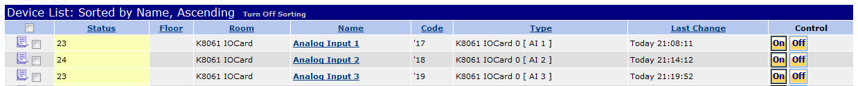

Finally I made a small script which translates the input value from the analogue ports (voltage) to the corresponding status and update a virtual device with this value.
So voltage between 1.9 and 2.5 means zone closed; between 2.6 and 3.3 meas open zone and everything else means sabotage. I decided to write a small vb script to limit the number of events I would have to create otherwise.

I tried to make a drawing how I connected my system as you can see below.
Koppeling Alarm K8061.JPG (100.17 KiB) Viewed 47143 times
To keep the drawing simple I only drawed 2 of the 10 sensors I have (S5 and S6) but the other sensors are of course connected in the same way.

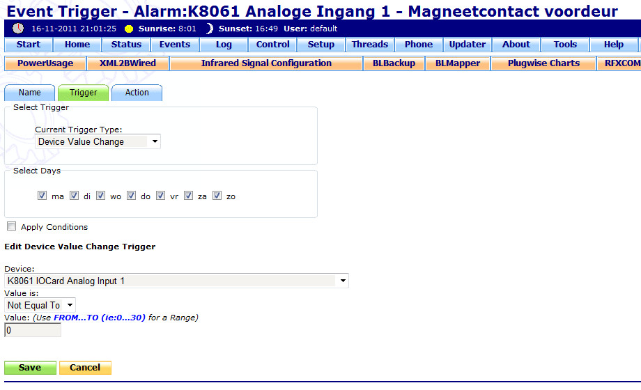

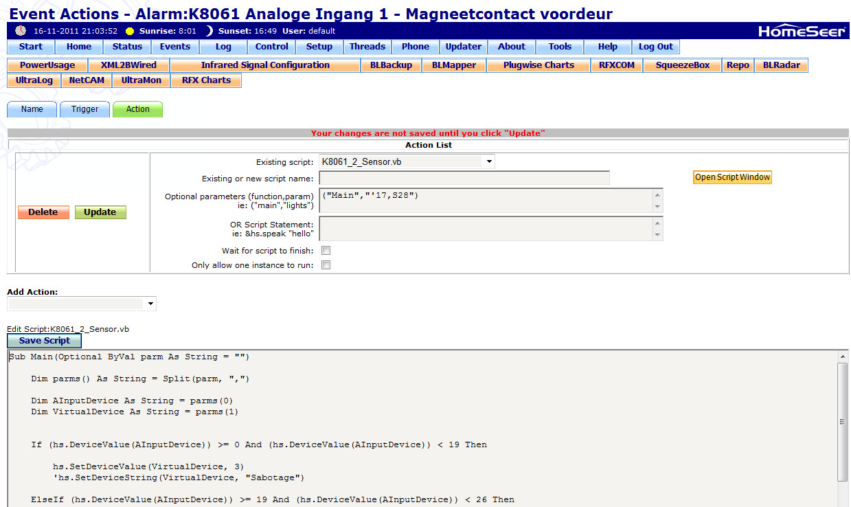

In HomeSeer I created an event for each input which runs a small VBScript. This script updates a virtual device to a meaningful status like the sensor has in my alarm system (Tamper, Open, Closed).
I use a small script to limit the number of events needed, but you should be able to do the same without the script. Please feel free to use my script if you like.
Sub Main(Optional ByVal parm As String = "")
    Dim parms() As String = Split(parm, ",")
    Dim AInputDevice As String = parms(0)
    Dim VirtualDevice As String = parms(1)
    If (hs.DeviceValue(AInputDevice)) >= 0 And (hs.DeviceValue(AInputDevice)) < 19 Then
        hs.SetDeviceValue(VirtualDevice, 3)
        'hs.SetDeviceString(VirtualDevice, "Sabotage")
    ElseIf (hs.DeviceValue(AInputDevice)) >= 19 And (hs.DeviceValue(AInputDevice)) < 26 Then
        hs.SetDeviceValue(VirtualDevice, 1)
        'hs.SetDeviceString(VirtualDevice, "Rust")
    ElseIf (hs.DeviceValue(AInputDevice)) >= 26 And (hs.DeviceValue(AInputDevice)) < 33 Then
        hs.SetDeviceValue(VirtualDevice, 2)
        'hs.SetDeviceString(VirtualDevice, "Alarm")
    Else
    End If
    hs.WriteLog("K8061_2_Sensor", AInputDevice & "->" & VirtualDevice & " set to status " & hs.DeviceString(VirtualDevice))
End Sub

Petermdevries thanks for all the effort,
As far i can see its verry interesting and very doable for me your way.
What i see you connected every input paralel on the first connector of the zone with a 20komh "weerstand"
Whats the reason you connected the gnd on the k8061this way? and not from the "hulpspanning" on 28 of the aritech panel?
Is it only possible to connect 8 inputs on the k8061
On my aritech cd 72 i have 16 zones is this possible using the digital inputs of the k8061 for the other 8 zones?
vr gr luis
petermdevries
Posts: 98
Re: How to connect a Alarm panel to Homeseer.
Post by petermdevries »
I think won't make any difference. I thought the best way to connect the gnd connections would be to use the gnd of the input connectors.
In that case you will have to "translate" the analogue output to a discrete signal. In that case you probably will have to use a solution like Francois is using.
