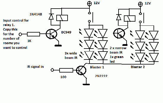

Another problem is reception. The further away the IR led is the weaker the signal and the set just won't respond. To overcome this
last problem i made an 'IR Blaster' for everyroom. Each blaster contains 3 high power wide beam IR leds, 2 high power narrow IR leds
and a small green control led to make visible when a code is send. Each blaster is powered by 12V and controled by an 2n2222
transistor. Because of this higher voltage i needed to seperate this from the 5V powerline used for the Arduino.
The multi room setup i have is solved this way.
Please note that the Mega has a different pin numbering
The IR library provide only one pin that can be used to send IR codes. However i want to send IR codes to the blaster i
select based on its location. To do this i made a blaster for each room and switch via a relay the 12V rail to that blaster
circuit. The output of the Arduino is connected to control transistor (2n2222) but only the one that have actually power will
send them out. The one that you use is based on the controle script. To operate the blaster you just send the code information
and the room id, that's it.

Here's an images of how the blasters in the rooms look like.
I have also white ones.
And a last look inside the box
Re: IR Project
With multi-room in mind most people will think it will need lots of hardware to accomplish that; but this solutions excels in simplicity IMO 8)
An inspiring DIY project, great!
