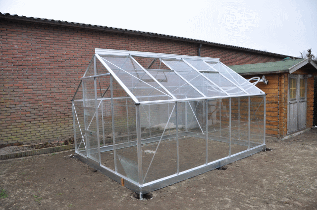

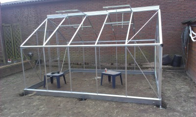

Tadaa...
I'll start a 'Greenhouse Automation' topic soon to hopefully get some inspiring input, cause I'm not the one with the 'green fingers' over here
Re: current scripts
I'ts looking like a real geenhouse.....My girlfriend and me both do not have green fingers, so no option for us.
Great job.....and looking foward to that automation as wel......can be done by one or 2 remote arduino's with a shit load of sensors. (temperture, humidity, watering system, lights..really everything)
