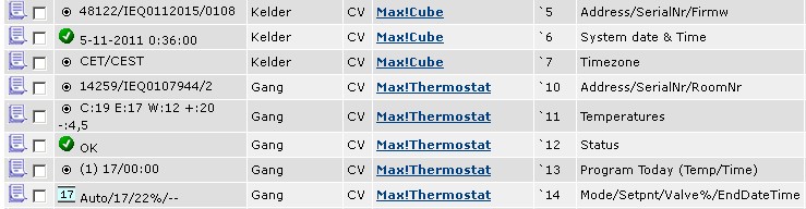

screenshot Homeseer status

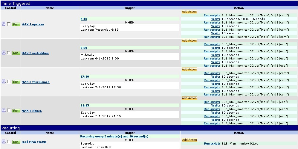

Created events:
screenshot HS events
HS CM MAX Events.jpg (136.08 KiB) Viewed 49732 times

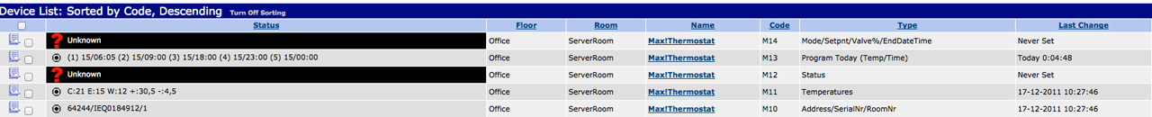

Here is a screengrab fromt the first (and only one) thermostat created. It might help finding the Out of bounds error:
Bastiaan

One other issue: it seems that 'Floor" and "Room" are switched when creating the devices.
