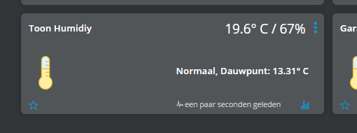

Maybe this will help you.
It is a Dzvents script (not tested, because it is a snip from my total Toon script)
viewtopic.php?p=100776&hilit=script#p100776
local ToonTempHum           = 588                                           --   Vochtsensor ID
return {
        on          = { timer = {'every minute'},
        logging     = { level = domoticz.LOG_ERROR, -- change to domoticz.LOG_ERROR when all OK
                        marker      = scriptVar
execute = function(domoticz)
        local ToonIP                = domoticz.variables('UV_ToonIP').value         --   IP address of your Toon
-- Vochtsensor
        local handle3 = assert(io.popen(string.format('curl http://%s//tsc/sensors', ToonIP)))
        local TSCsensors = handle3:read('*all')
        handle3:close()
        jsonTSCsensors = json:decode(TSCsensors)
-- Update the BoilerMoisture sensor to current value
        local TSCsensors_hum = tonumber(jsonTSCsensors.humidity)
        local TSCsensors_temp = tonumber(jsonTSCsensors.temperature)
        domoticz.devices(ToonTempHum).updateTempHum(TSCsensors_temp,TSCsensors_hum).silent()
   end
2022-10-23 10_00_17-Domoticz - Temperatuur.png (13.36 KiB) Viewed 5840 times

You need to use the Temp+Hum sensor type as a virtual switch
